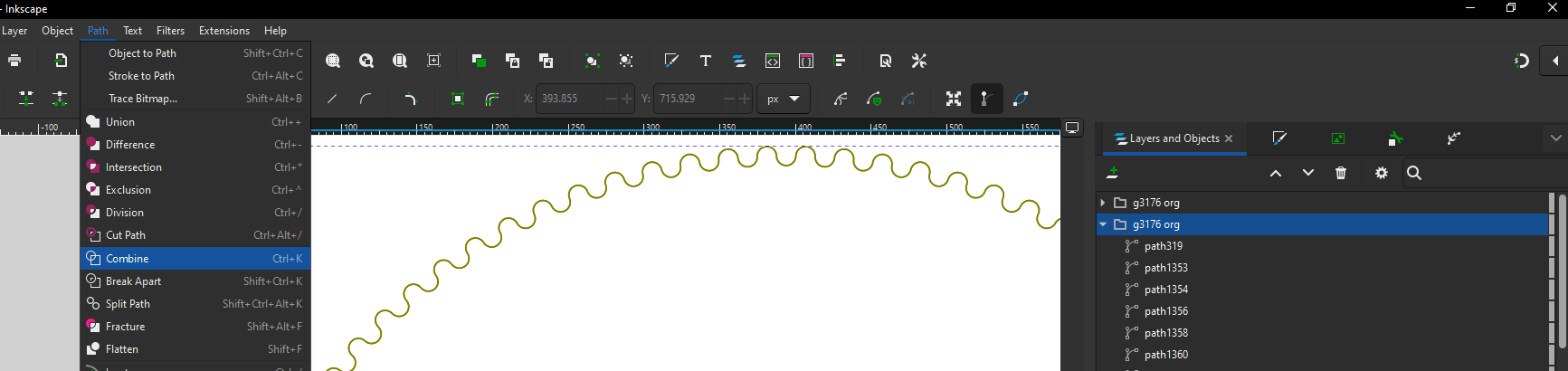

    -Set Stroke style > Width to ‘Hairline’.

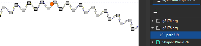

    -menu > Path > Combine [ctrl][k] to get one path for each item:
    Result is a combined path (Afterwards, you can ‘Break apart’ if you want)

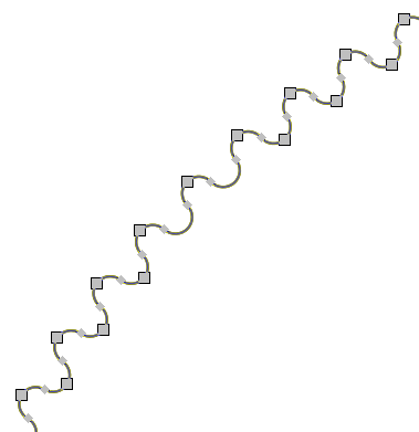

    - Node Tools > Edit path by nodes [n]
    You see:

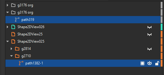

    -In tree, select all combined items to be given an offset:
    -Select all nodes (!!) with [ctrl][a]. You see blue indicators:
    Join selected nodes [shift][j]
    (An invisible change is applied to the selected items! Or???)

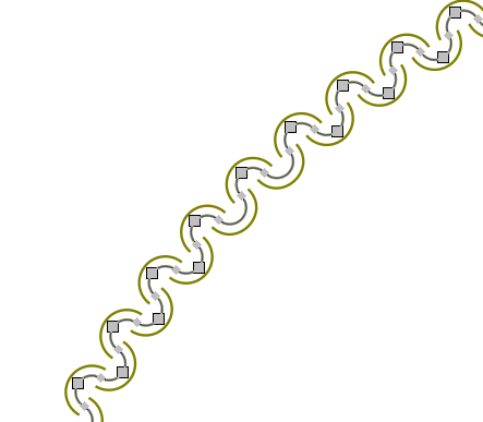

  3. Step 3: Apply Kerf Offset
    -For offsetting, selection of only 1 path, shape, clone or Group is permitted.

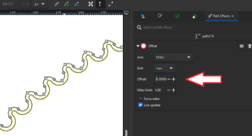

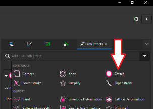

    - menu > Path > Path Effects… [ctrl][&], ‘Add live path effect”: Offset
    - Change Offset as you whish.
    (Negative for other side/direction. For lasercutten: kerf / 2 ?)
    -Change colors of the result-paths, etc.

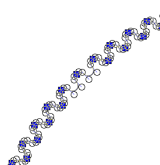

    -Save as .dxf R14.
    -If you get this, then you didn’t select all nodes with [ctrl][a] before ‘Join selected nodes’.
