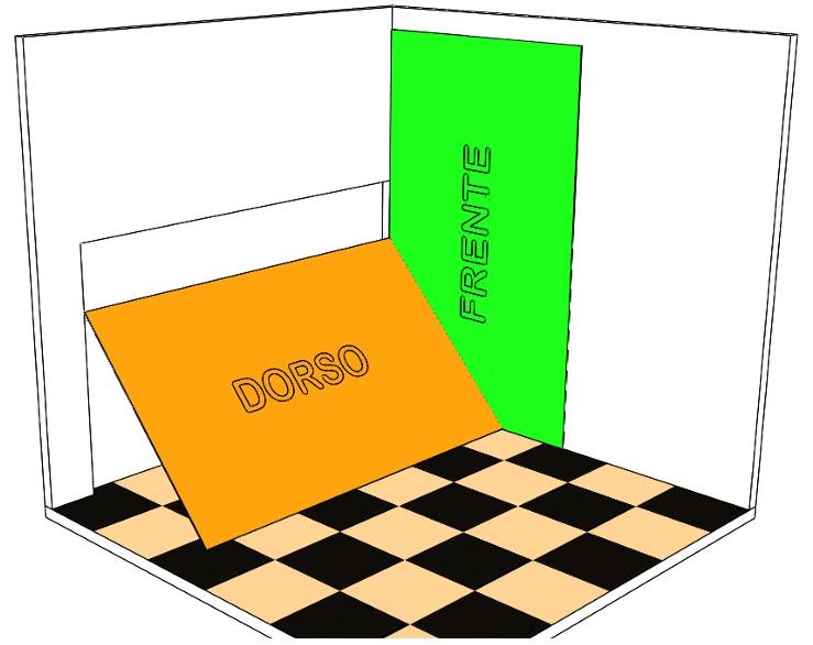

    We should first take the original problem statement:
    • Original statement: be a rectangle with one side green (front) and the other side orange (back). Its initial position leaves the orange face visible, with its long edges in a horizontal position. Its final position leaves the green face visible, with its long edges in a vertical position. It is requested to design a mechanism capable of moving it between both positions.
    • Graphic: in the following figure the orange and green colors are associated with two different faces of the rectangle:
    Then analyze it and create a new version in which we relax or remove some restriction that, a priori, is complex to satisfy and may be limiting the fluidity of our ideas. This is arbitrary and there is no one way to do it, but here is an example of an alternative:
    • Simplification: let's forget (for a moment) the requirement to differentiate both sides of the rectangle (orange and green) and simply ask to go from the initial position to a final position with the long edges vertical.
    • New statement: be a rectangle located with its long edges in a horizontal position that requires moving to a final position where its long edges are vertical. It is requested to design a mechanism capable of moving it between both positions.
    • Graph: although the following graph is the same as the original, its meaning is different, more general, less restrictive. The colors now simply represent the starting position (landscape) in orange and the final position (vertical) in green:

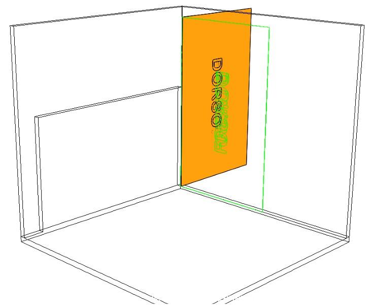

    It is advisable to make good drawings to make the instructions clear before proposing solutions. This will lead us to realize that the rectangle has two faces (front and back) although without the obligation to condition the movement to them:
    Identifying the faces (front and back) of the rectangle will make it easier for us to recognize all the “orientations with long vertical edges”:
    How many different cases will there be?
    In this example, a simple analysis allows us to recognize four different cases or ways in which the rectangle can be placed in its final position starting from a certain initial position:
    CASE 1: facing the FRONT with counterclockwise turn
    CASE 2: facing the FRONT with clockwise rotation
    CASE 3: showing the BACK with counterclockwise rotation
    CASE 4: showing the BACK with clockwise rotation
    As a summary and visual stimulus, we graph these cases together to anticipate the structure of the future SCS (Solution Concept Spectrum):
    Note:
    At this point someone might ask... why were the other four cases in which the rectangle in its initial position leaves its "back" visible not analyzed?
    Such cases exist and are valid but totally symmetrical to those already raised. That is, two situations will be found again in which the same face (the back in the previous figure) appears in two possible final positions (with counterclockwise rotation and with clockwise rotation) and another two situations where it is the other face ( the front in the previous figure) which appears in the final position in two possible orientations.
    In this way, the same mechanisms that resolve cases 1, 2, 3 and 4 are those that could resolve the other four additional cases.
