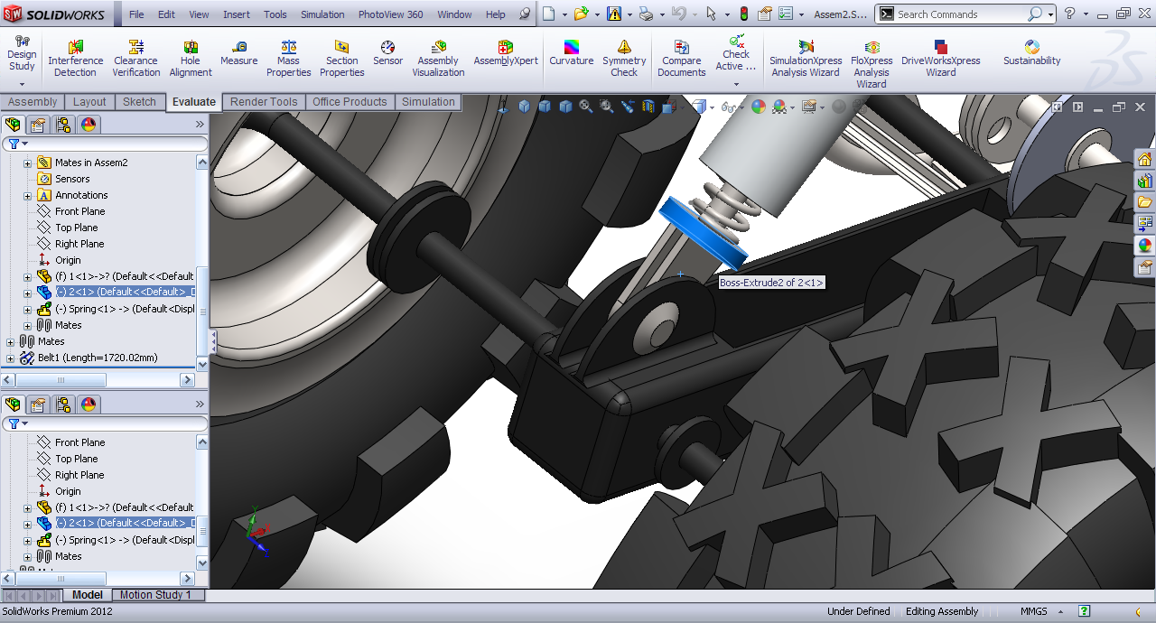

At first I was also messed up with this when i was making a model of ATV and had to mate a shocker. Here is the Solution.
Step 1:
First of all open the Main Assembly. As you can see there is a shocker and it is locked.

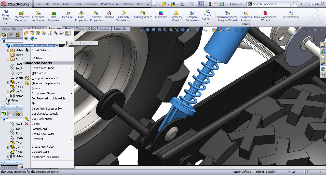

Step 2:
I right clicked the sub-assembly of shocker and selected Component Properties.

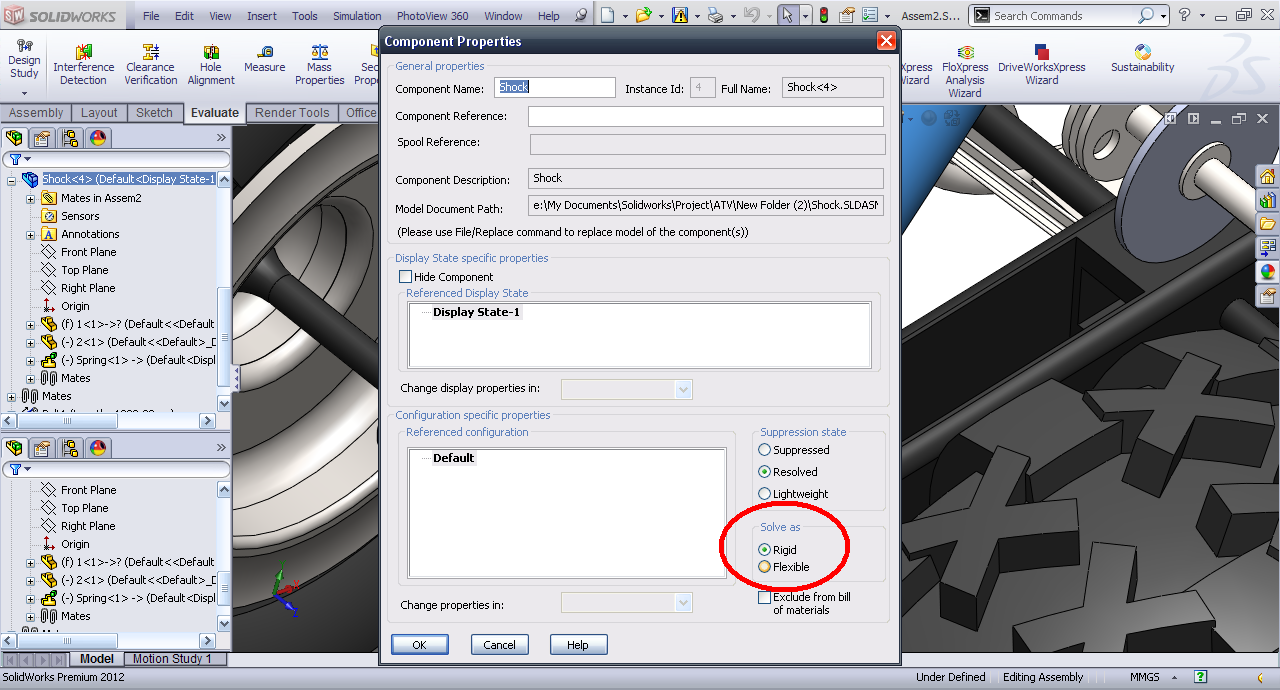

Step 3:
Then in Solve as select flexible.
Step 4:
Click OK and the sub-assembly is flexible.
