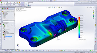

11. Now select external force option and select force and its value and on which face you want to apply and value of force you want to apply.
12. Now select mesh and change it between corse to refine according to your requirement.
13. Now after all above steps click on run this study tab present above in workbench.
14. Now result will come on screen in von mises table.
15. Now change designe of your product if neccessary according to result and after that click run this study again to get new result.
