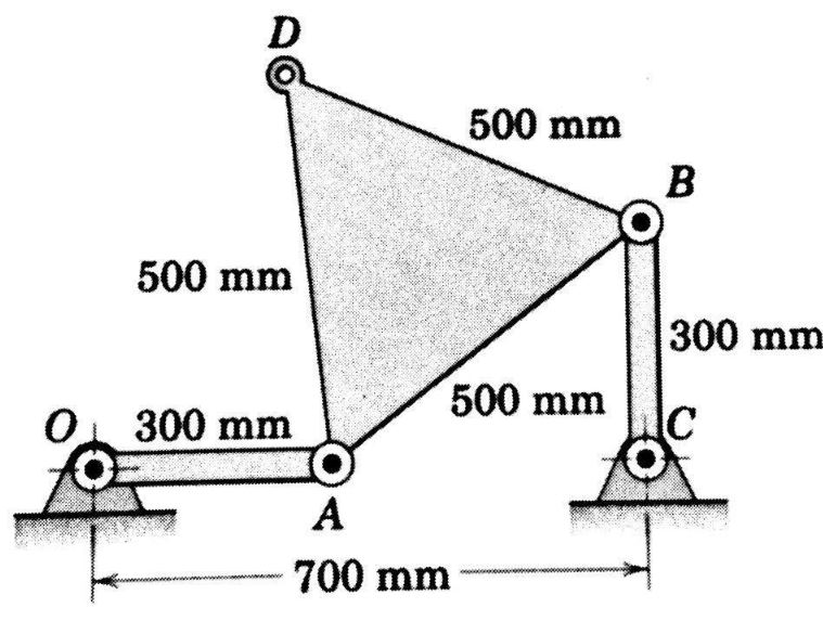

First we should know the question that says :
In following mechanism the triangle ABD, rotates CW with angular velocity 3rad/s & angular acceleration of OA equals zero. pleas calculate the angular velocity of ABD triangle & BC.
