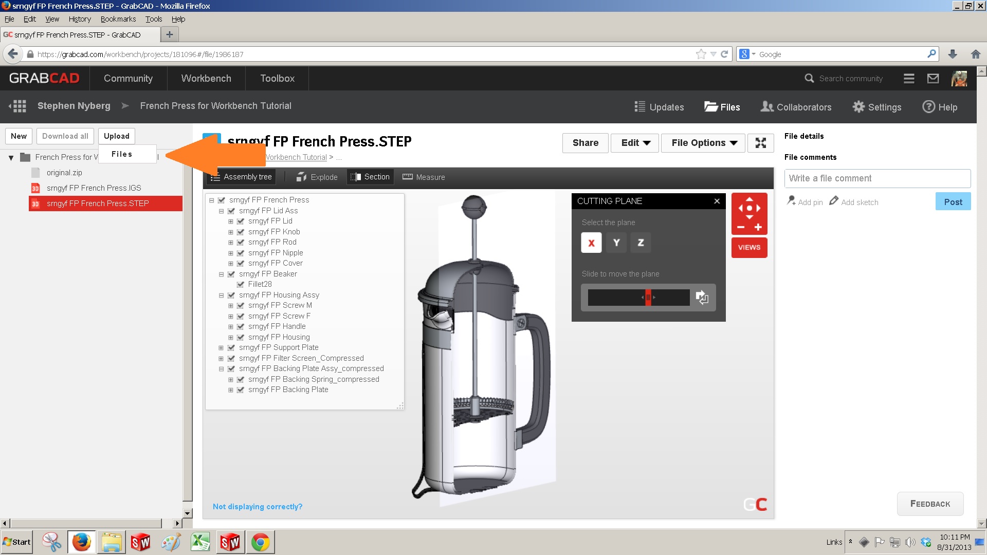

Lets upload our assembly fiel to see how this works.
On the left side of the screen click Upload and then files.
(Firefox does not allow folder uploading I will show this later in Chrome)

Step 11:
Again a progress bar will open and you leave a comment as to what the new file you are uploading is. When it is done and turns green, select "done."
Step 12:
If we now take a look at this file in the 3D viewer, we can see that it open without the need for all the part files and sub-assemblies. It also look different from the universal formats. (a few tangent lines are no longer there and materials are closer to original.)
