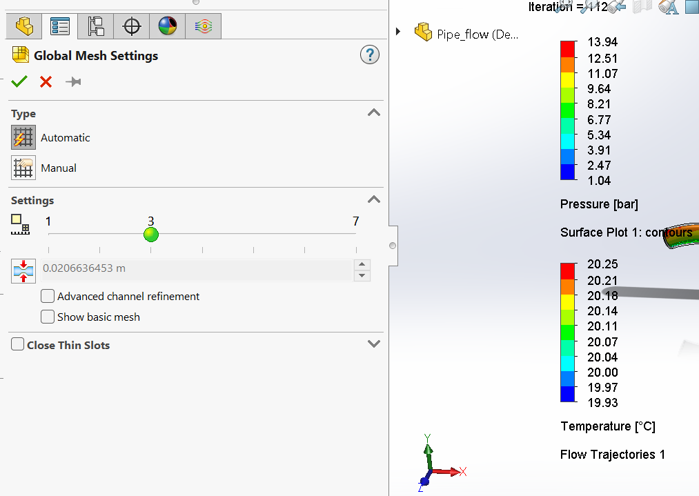

  5. Step 5: Meshing and Results
    Meshing is a crucial part of any analysis project and results heavily depends on how meshing is done. In SolidWorks a primitive of form of meshing is provided which may be inaccurate for complex geometry. It gives a general idea that how our analysis will look like. It is good enough for general results.
    In this example we will select automatic meshing. Just to remind you again meshing is a critical part in FEA/CFD Analysis.
    After meshing click on run and solver will solve all the boundary conditions over governing equation and this will look like this.
    After this we have to work on post- processing and result customization. Hence our equations are solved and numerical results are obtained.
