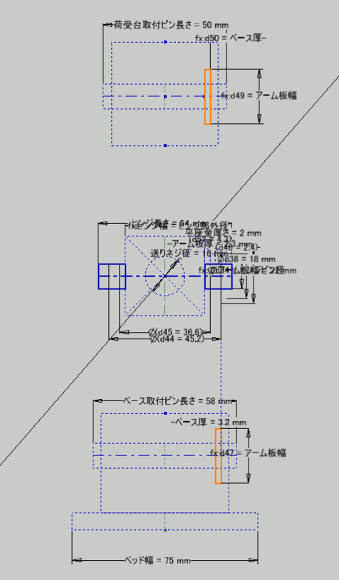

skeleton
For the basic specifications, we take the dimensions from the book as they are and create a skeleton. This time, since it is something that moves like a pantograph, I also created a sketch of the skeleton so that you can check the movement.
The structure of the pantograph is designed to ensure the width of the part that receives the load, and to ensure that the loading platform remains horizontal even when the jack moves up and down. In reality, the gear shapes are squeezed together to prevent rotation, but at the sketch stage, they are made horizontal using geometric constraints.
In addition to the part showing the actual posture of the arm, a horizontal sketch has been created. This is because it is easier to work in a horizontal state when modeling parts using a skeleton.
Create a sketch of the right side based on the end of the lead screw. The reference position is geometrically projected from the front sketch.
Check operation with sketch drive
If you change the parameter called jack height, the pantograph will move up and down. If you change this parameter continuously, you can check the movement of the pantograph.

Step 3: LOD200 Multi Solids
LOD200 conceptual design model
Use skeletons to create conceptual design models of major parts. We will use multiple identical parts, but only one of them will be created here. Also. Create on the part model. Each part will be a multi-solid part model created with solids.
Although there are differences from the completed model, it is good to use this model as long as you can see the image of the completed model and the connections between the parts.
Pay attention to the arm. It is modeled in a horizontal position. The arm is a moving part that follows the vertical movement of the jack. Later, we will use joints to constrain it. Therefore, it is made horizontal to make modeling easier.
Create the main parts as multi-solids. Detailed design derives this solid model.

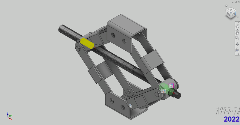

Step 6: LOD300 Slider joint on loading platform
Movement of loading platform
The loading platform moves up and down in accordance with the feed of the jack screw. One way to give movement is to use assembly constraints, but we will use joints, which are easier. The joint has the same function as the joint provided in Fusion360.
Show only selection
Display only the necessary components for easy operation.
Remove the fixing restraint of the loading platform.
Select only two components, the base and the receiving bed, and execute Show Selection Only from the context menu.
Show skeleton sketch
From the browser, expand each component to display the skeleton sketch (front SK) inside the derived component.
Set the slider joint
Set the joints using the edges of the skeleton sketch. Name the joint "Location position".

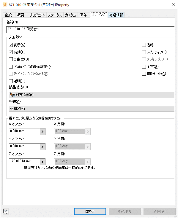

Fixed and restrained loading platform at origin
Return the loading platform to the origin and to the fixed restraint state. I will be attaching the arm to the loading platform later, and I want to make it easier to attach it at that time.
To constrain it to the origin, set all XYZ coordinates of the occurrence to zero. It takes a lot of time to do it manually, so I create a rule in iLogic that fixes it to the origin and use it.
I made a video of the series of operations.
Step 7: LOD300 Rotating joint on arm
Place arm
Place the arm that was made into a subassembly. The method is the same as last time. Place the arm and display the front sketch of the skeleton from the base and arm browser.
Add rotation joint
Add revolute joints using the skeleton sketch.
Follow the same steps to set up the upper arm as a loading platform and rotation joint.
Mate Constrain of arms
Add mate constarain two arms. Since there is only one degree of freedom left and it is easy to operate, we use a mate constraint for axis alignment.
Check movement
Remove the fixed restraints on the loading platform and check the movement.
movie

When making drawings, the jack must be in a fixed position. I call this as original position. In the case of a loading platform, you can simply constrain it to the origin, but since it has already been placed, you cannot use the component placement menu.
To place a component at the origin, all coordinates (x, y, z) of the placement position should be set to zero. You can specify it from the occurrence tab of the property, but it is a bit troublesome.

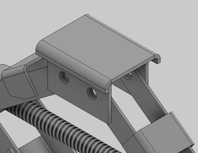

Fixing the receiving plate to the receiving platform
The loading plate is fixed to the loading platform. Since these two parts are derived from the same skeleton, they can be fixed by flush constraining the basic work planes.

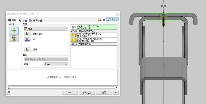

Step 10: LOD300 Bolted Connection Generator
Secure the loading platform and loading plate with bolts. The flange of the receiving plate is prevented from rotating, so only bolt it in one place in the center.
bolted connection generator
Use a bolted connection generator. The bolt connection generator is an excellent product that not only inserts bolts but also creates holes (screw holes) at the same time.
On point, option
My favorite method is specifying points. This is because it requires the least amount of work, as it is sufficient to specify the hole position using sketch points at the skeleton stage.
Temporarily display the receiver plate sketch from your browser.
Start the bolt connection generator and place the bolt on this point.

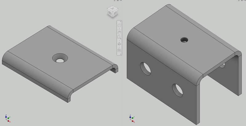

Hide the sketch and complete the installation.
Hole features are automatically added to the receiving plate and receiving platform parts.
