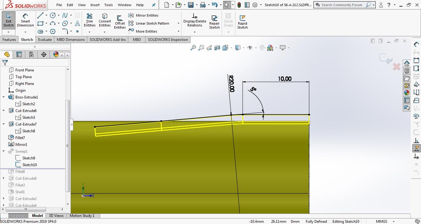

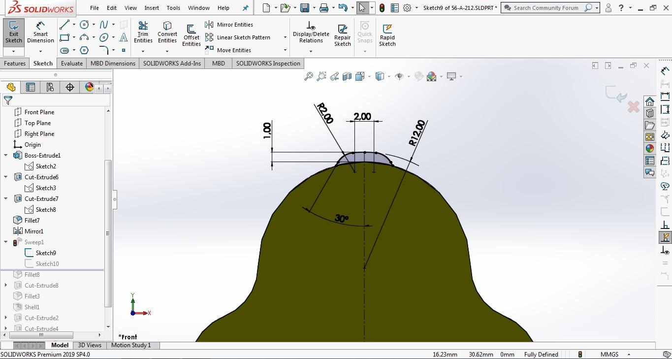

    Sketch the tightening rib section and its profile which will be used as trajectory for "Sweep" tool

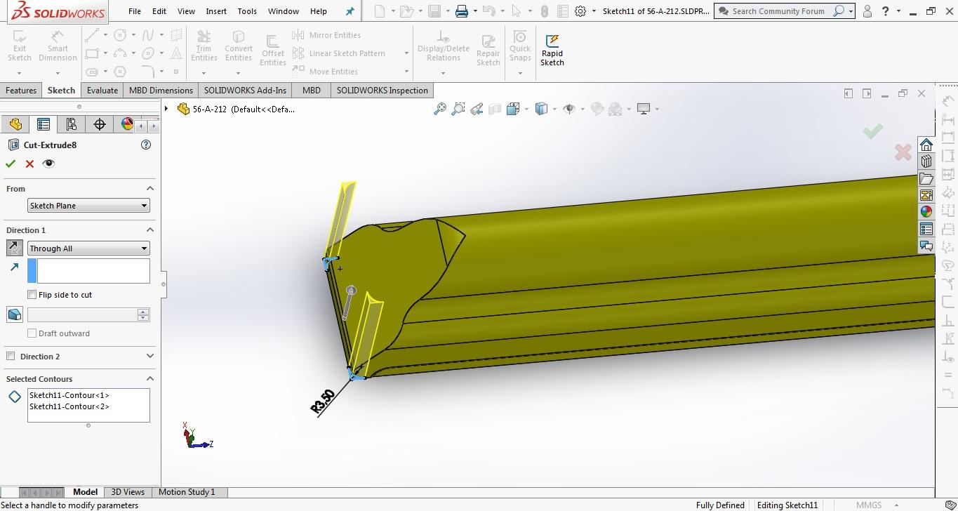

    Round the corners of the vertical face using "Cut Extrude" tool - drawing radius is 2,5~3,5mm, so we can use 3,5~4,5mm since we are modeling outer shape. You can possibly use "Fillet" tool however that will round also the edge on the angled face which is not necesarily rounded using the same arc size.

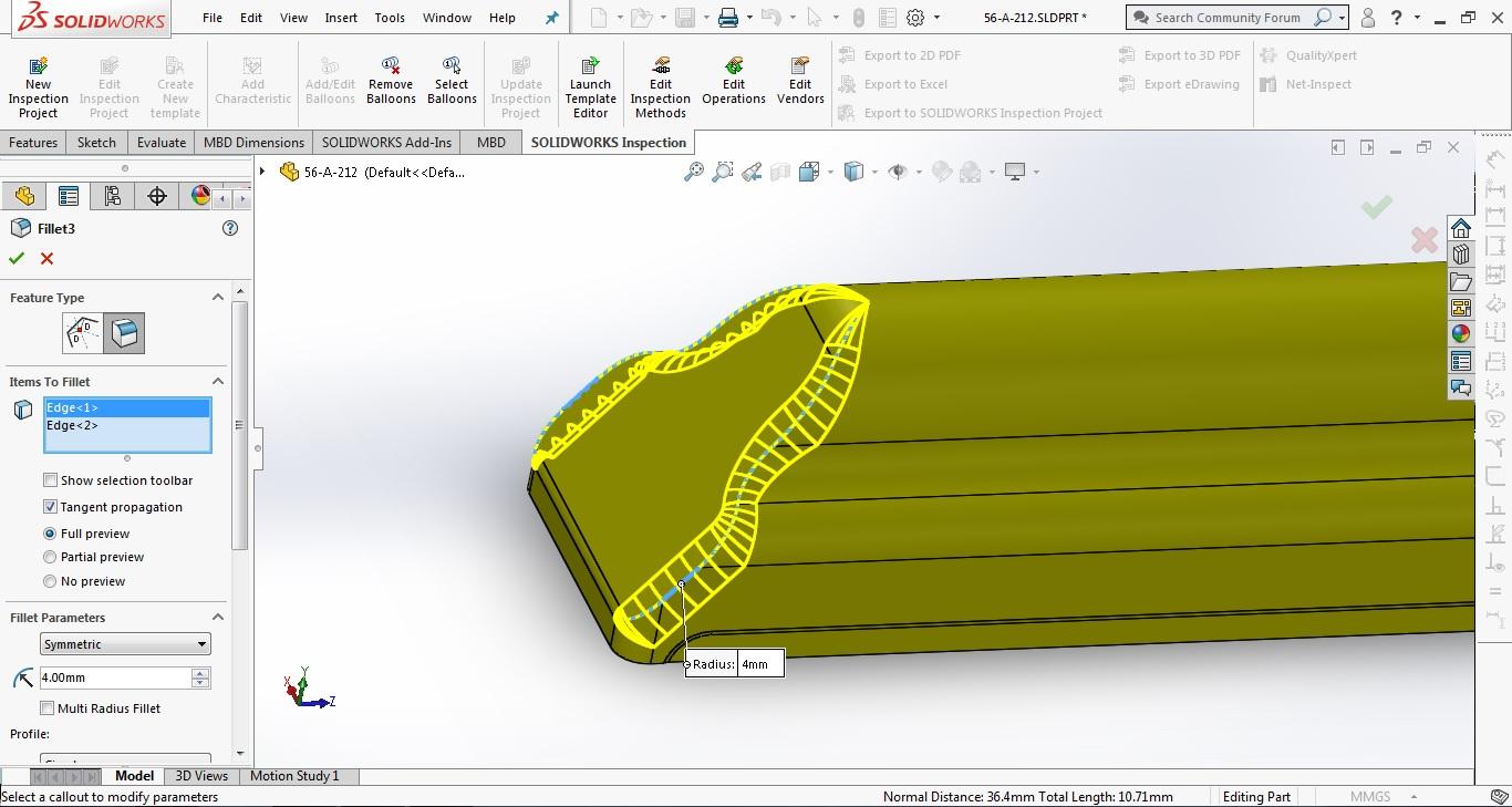

    Round the edge of the angled face using "fillet" tool - value is 4mm

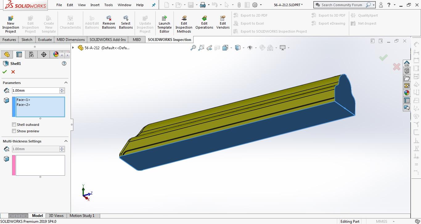

    Make a shell using "Shell" tool. Make sure that all edges and corners which should be filleted are done, set 1mm thickness and select bottom and front faces to be removed. As i mentioned in a "Step 1" - just in case you chose to model inner surfaces you can check the "Shell outward" box.
