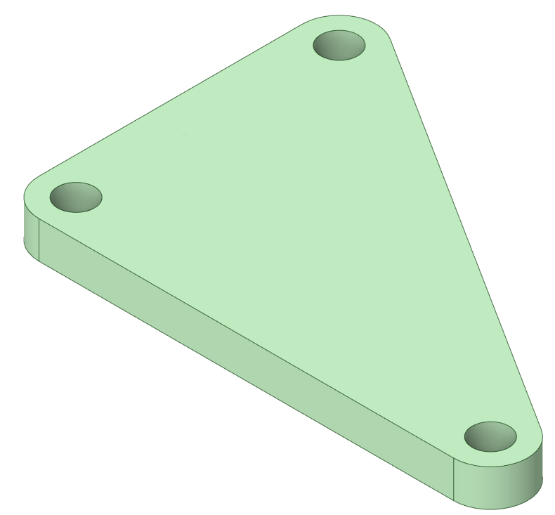

Step 4: Geometry (SpaceClaim Model)
- The triangular bracket has been designed on SpaceClaim could be seen below:

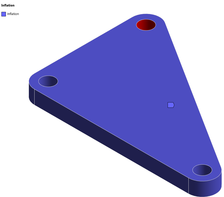

- The mesh refinement on point of interest (the area which has the maximum stress) has been refined until the stress value difference between two adjacent nodes is less than 10%.
- The first refinement on point of interest have been implemented as Body Sizing / Sphere of Influence with 1.5mm of Sphere Radius and 0.11mm of Element Size:
- The second refinement has been implemented as Inflation with 3 Layers and 1e-002mm:

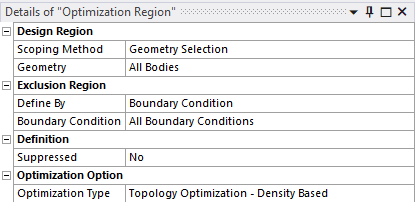

Step 8: Topology (Structural) Optimization
- Firstly, the engineering data, the geometry, the model and the results from Static Structural must be connected with Structural Optimization Analysis:
- Analysis Setting of Structural Optimization could be seen below:
- The Exclusion Regions (bearing load and cylindrical support areas) and Topology Region could be seen below:

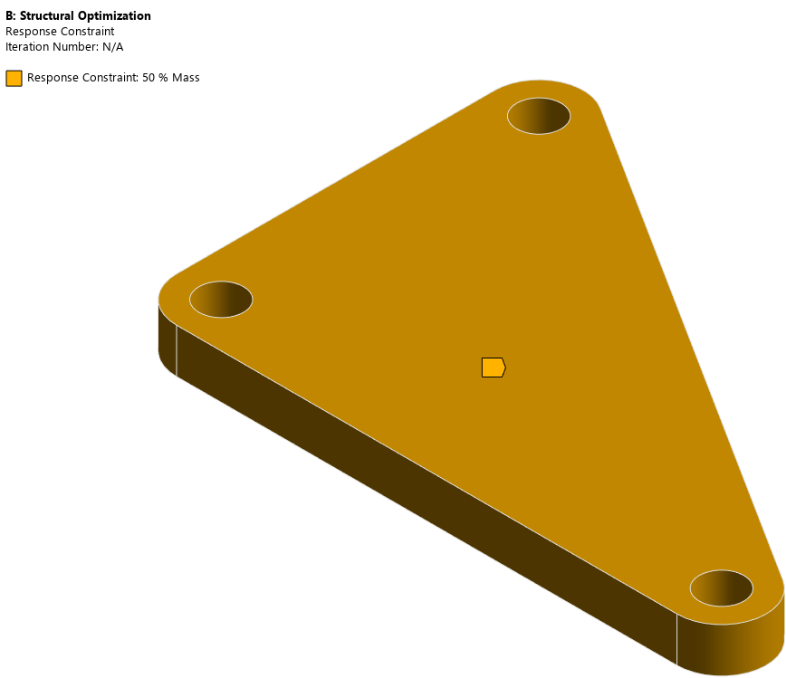

- Material Density (Response Constraint) Reduction with 50% Mass has been determined:
- The result of the Topology Optimization could be seen below:
