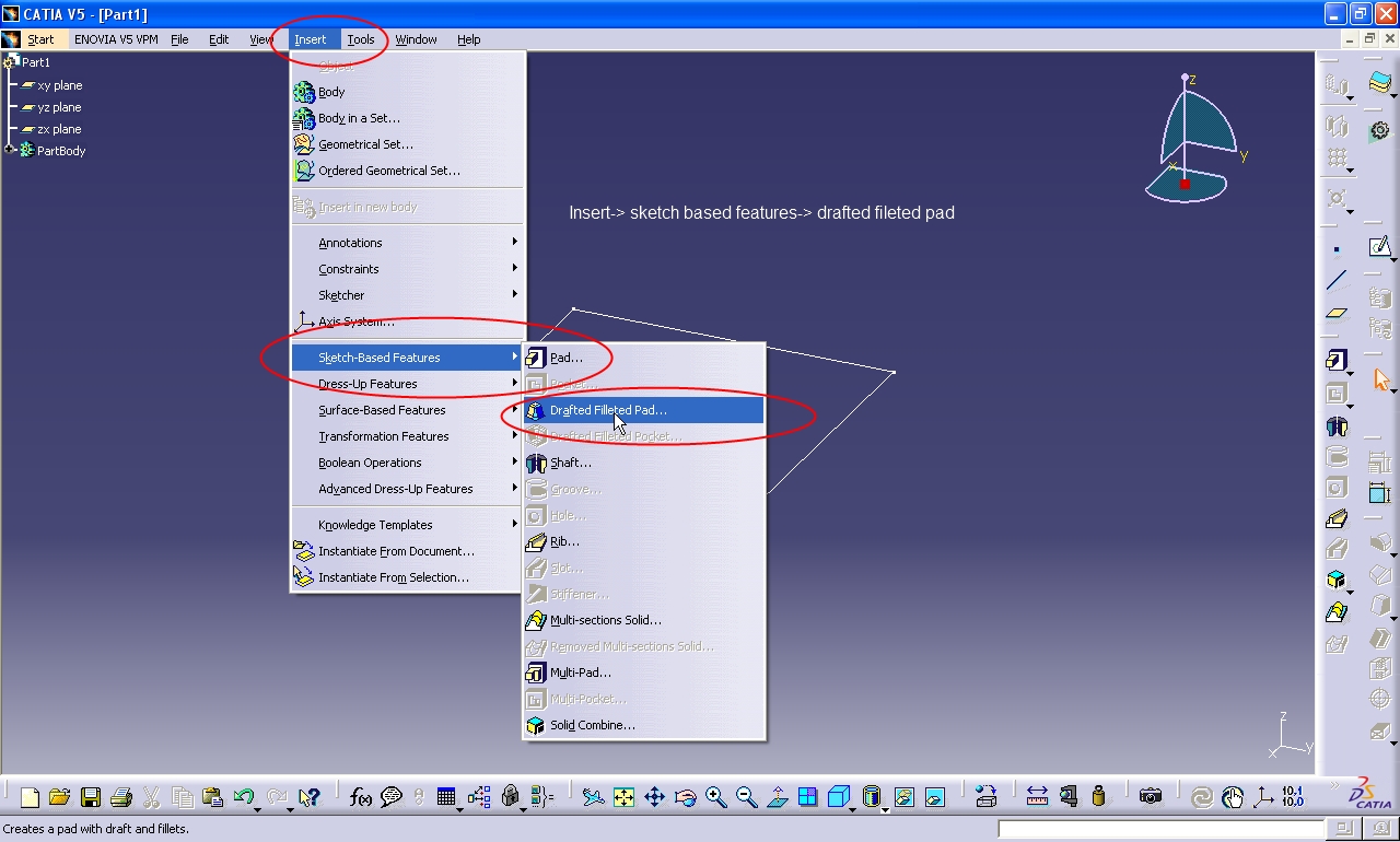

Step 1:
sketch a rectangle on the xy plane. Insert sketch based features->drafted fileted pad

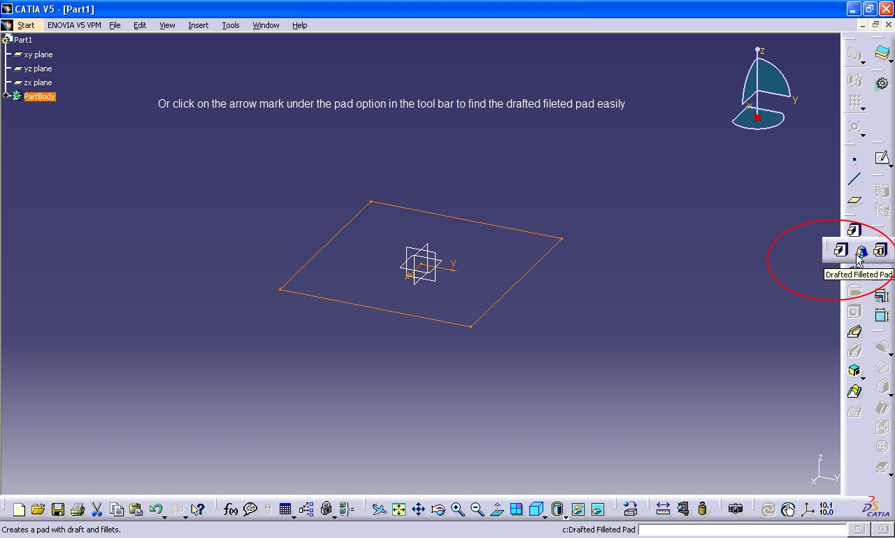

Step 2:
Or click the arrow mark below the "pad" option to get it from your tool bar.

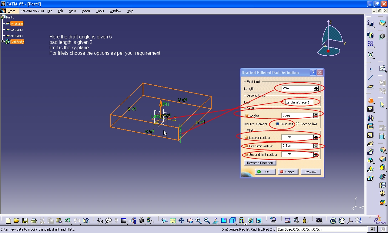

Step 3:
Fill the parameters as per given in the figure.
Step 4:
This is the result for the above parameters.

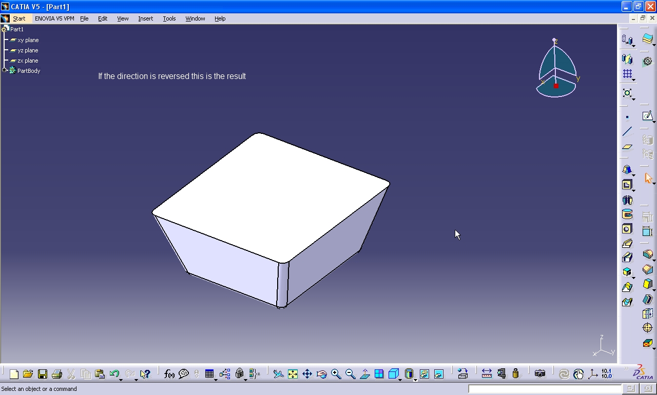

Step 5:
If the direction of padding is reversed, this is the result.

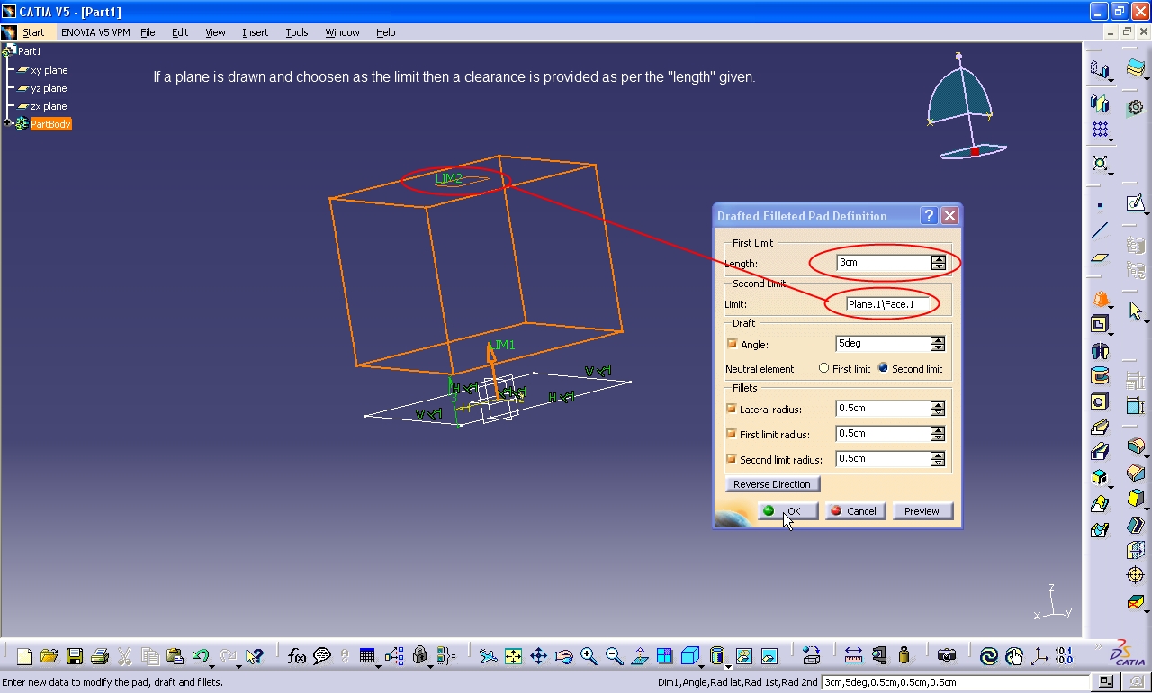

Step 6:
Now let's do the same drafted fileted pad by using a plane as the limit. You will get a clearance in this case.
Step 7:
If the direction is reversed in this case then the clearance is not provided.
