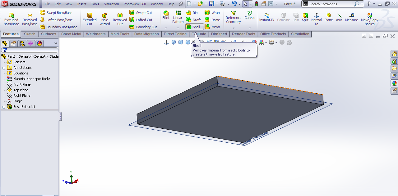

Step 4:
Shell.
Step 5:
Select lower face and distance be 5mm.
Step 6:
Fillet the otuer edges by 5mm.
