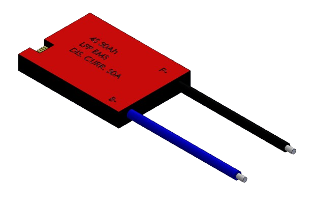

  1. Step 1: 12V 30A BMS (Selection)
    In this photo you can see that making for BMS in side you can see some pins are their your BMS sensing wire. Here is two more wires for Battery negative and Pack negative. Battery negative (B-) is for Final negative wire of your overall battery negative wire of your battery pack. Pack negative (P-) is for overall pack negative connection with your soft pack.
    In this BMS you can see some specification (4S 30A / LFP BMS / Dis. Current 30A) This means that this BMS is suitable for 4 series = 12V packs, 30 A is peak charging or discharging current, LFP pack support and it's max discharging rate is 30A.
    If you want to create this as part in 3D CAD must click this link here i made this and tell step by step making of lithium-ion packs.
