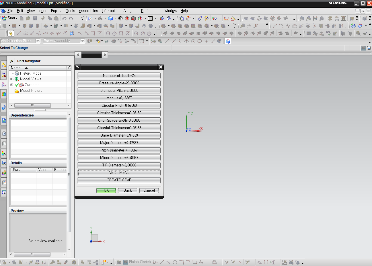

Step 4:
- select gear type. ( i selected spur)
- click ok. -
Step 5:
- input gear options.
- if the selection is done, click 'create gear'
- click ok. -

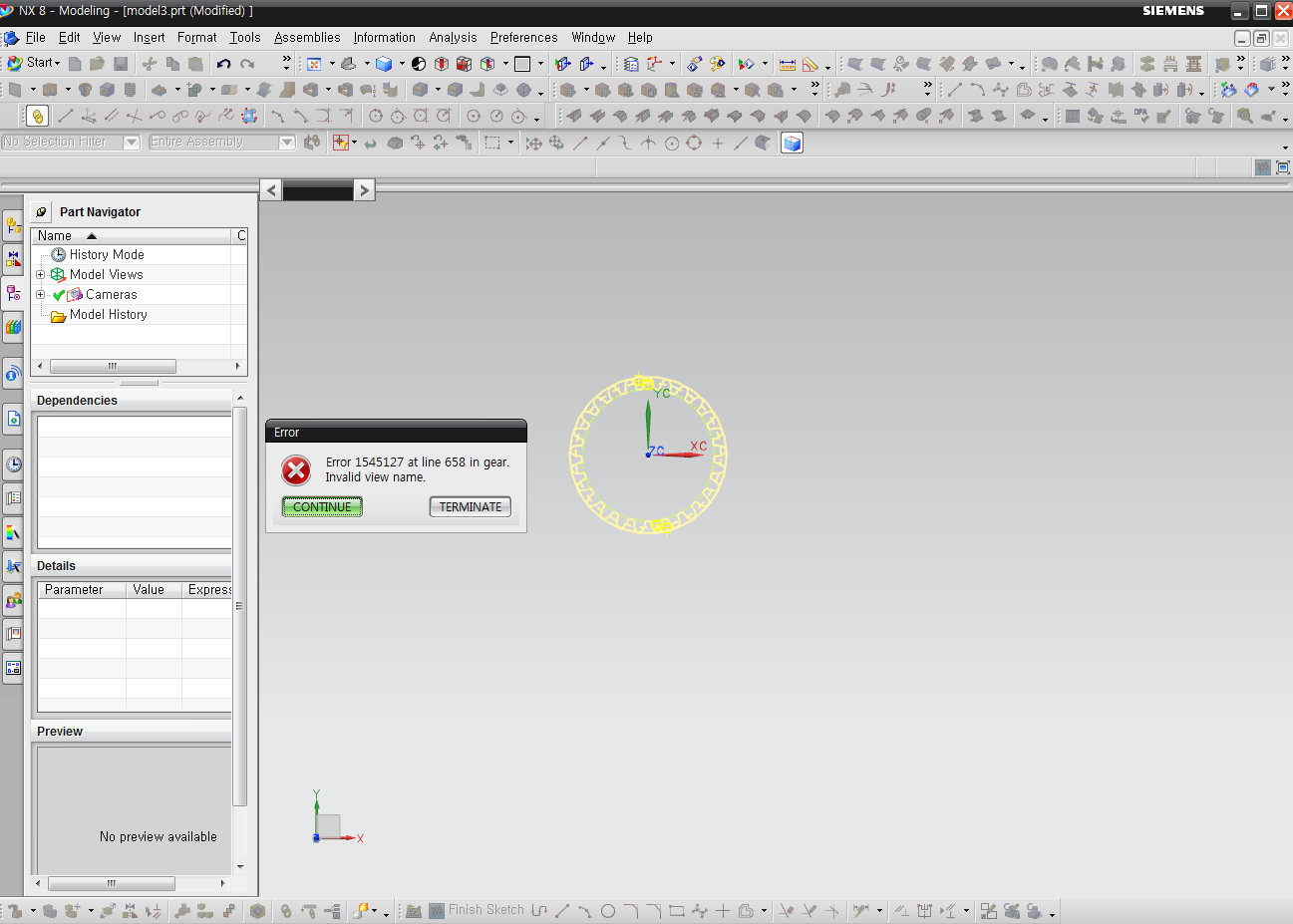

Step 7:
- never mind with error.
- click terminate. -

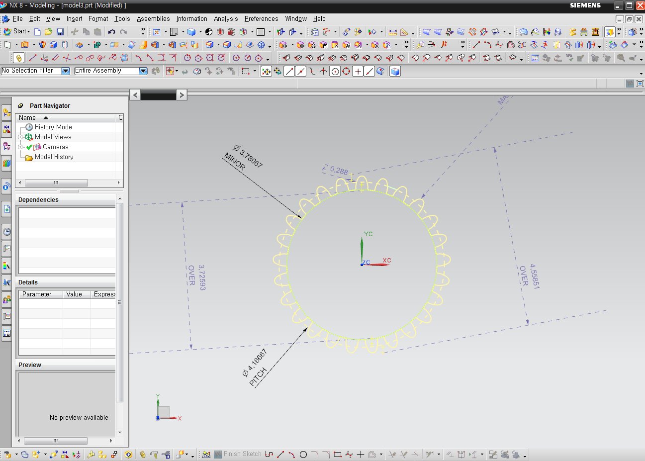

Step 8:
these are gear curves.

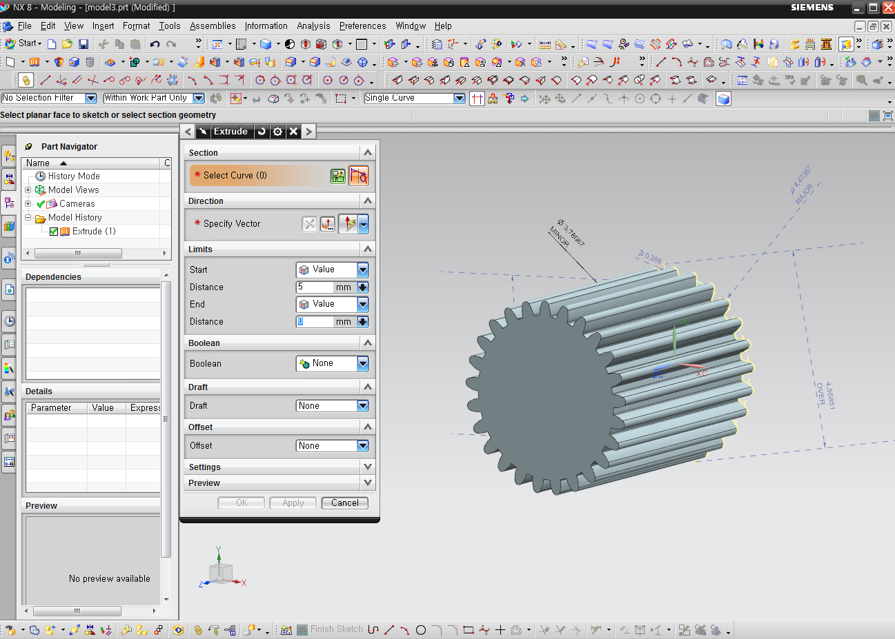

Step 9:
- extrude
Step 10:
this is bevel gear modeling sample.
